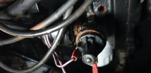

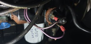

Hey, like Scott06 said, down near the oil filter. Port side on my engine.
Here is a picture of the one I replaced. Might help you locate it (you can see it was pretty rusty).
The oil pressure switch is the one with two wires. If you join those wires, it bypasses the switch.

Corroded terminals on that switch is a VERY common problem... Your symptoms fit exactly. Pull the connectors and link them with a bit of wire. If that fixes it, then either try to clean up the corrosion or replace the switch.
Chris...
