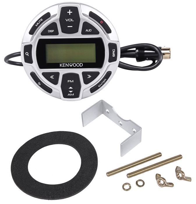

I currently have a Kenwood KMR-555U headunit mounted in my cockpit and am about to add a KCA-RC55MR wired remote to the swim platform of my 1998 Searay Bowrider 210. The installation will require a 2"+ hole. I know when drilling into the gellcoat , I should drill in reverse to prevent cracking of the surface. I was wondering what the procedure is when using a hole saw bit? Should I start in reverse with the centering bit until I get past the outer layer of gellcoat, then switch to forward until I drill completely through- then go back to reverse again when the 2" hole saw contacts the gellcoat, then forward once again once I get thru the top layer? I tried searching online and couldn't find anything certain. Thanks in advance.

Drill the hole with just the pilot bit in forward. It doesnt matter if the gellcoat cracks there because that part is getting cut out. Put the hole saw on the pilot bit and start in reverse like you mentioned, then go in forward. Easy piesey.

Running backwards to score the gelcoat might work. I applied masking tape, also. A forstner bit works really well; that's what I used when I installed my transon-mounted trim switch.

Thanks for the replies guys! I've got a couple of projects for the boat ahead of me tomorrow and that is one of them. I've already got the appropriate sized hole saw in my toolbox that will work for this install. Is there any potential issues with using a hole saw bit vs a forstner bit? Hole saw bits seem a bit too aggressive to me in this application.

Both will work; Forstner bits will give you a very clean, smooth hole. Hole saws leave edges that are a bit more raggedy.

I finally got it done using a 2" carbide bit meant to drill holes through fiberglass bathtubs and shower stalls. It worked great and went through like butter. I tell you I don't think i'll ever get used to drilling through the boats structure. Anyways, here are a few pictures. I have a 3" rubber end cap on the way that i'll use to cover it with when in storage. Thanks for the input guys.
