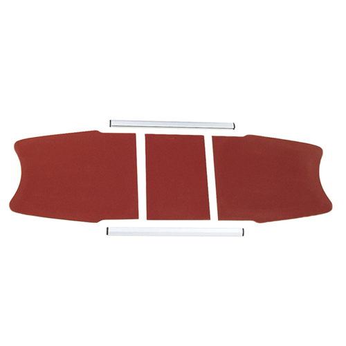

for a soft-floor inflatable? Here is an example of a pic i saw online of a
floor board
I see the shape, but i need more detailed advice, my my buddy kernal3
asked above, what type of material to use to build it? do i let the DIY
floorboard sit on direct contact with the soft floor of the boat?
do i need to cover the bottom of the floorboard with something so it
it sits softly against the floor? Is this safe?
