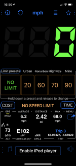

it’s a 5.0 mpi I have Scott. 260 hp standard. With my cam and exhaust system…I’m assuming it’s nearly or around 300hp. But annoyingly…unless it’s anything over 4000 rpm or more…it’s just not a good set up all round having that cam. Wasn’t much thought went into it I’d think. Was only about 15 of them made with this performance package. Nice to have…but reality is that it would likely be more useable with a 350 mpi. Funnily enough, the non performance package could be optioned with a 350 mpi or a VP 5.7 gxi. The specs claim the performance edition was slightly quicker top end though. So assume she’s at least 300 hp perhaps. Not sure. She’s still limited to 5150 rpm. Which she will easily hit with any prop that’s useable. Would take a 23” or more to keep her off the limiter with the 1.47 ratio. But that means it’s just terrible anywhere less than flat out. She’s a quick wee thing though. Considering her fairly heavy bulk. 1400 kgs dry. Still manages the below gps if I can be bothered to suffer the other effects down low. Most often I can’t though and run a 21” or even a 20”
