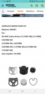

What was the kit part number your using?
Through Amazon UANOFCN 984461

Who makes it? Sierra or GLM ?
I"d try ordering an OE OMC/BRP housing and impeller kit. I never had that problem with theirs.

The part number is correct but coming from Amazon it can be rolling the dice. Might be good but may also be counterfeit. It says replaces that number.
Does list sierra impeller 18-3058
Might also be how your assembling. The housing should mount flush with no need to press and pull into place

I'll double check to see if it sits flush or not. I'll report back. I don't believe it referenced the Sierra number. I'll order the oe omc part number even if the old setup does sit flush. Worst case scenario if it ends up being the same and its something else is wrong I'll have a backup.
