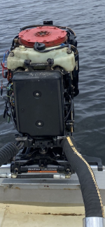

Just adding a couple pics for clarity. BTW, the carb stamping reads WH-29 (hard to read).
Dukedog
Oct 6, 2009
3,520
tha # 0C184366 shows ta be a '89 2.4 200 on Mercnet site.. that one is not a 200 for sure.. looks like ya have a hodge podge (jus chargin' system maybe?) of a powerhead??? where did you get tha 0C184366 number?.. tha one in your pictures looks ta be no newer than '86.. could be a 2.0 150 or 2.4 175? don't remember what tha WH 29 came on.. tha 40 amp stuff didn't come out till '89 either..

Sorry to jump onto your post. Just very closely related to this though. Maybe help, given the incredible knowledge in responses. Any idea what this engine is ? It has been re re decaled from what it was originally for sure. Or had a more recent cowl on it to original. It’s different to any other mercury 150 I’ve seen. Carbs are different and few other things. It has the decals and clamshell from the mid to late 80’s on it now. But that’s been put on her in the last decade. She had a different cowl decal style originally for sure. It’s got serious power in it. I’ve had a few 150 2.0 mercs and known dozens of others over the years…and none of them were anything close to as powerful as this. It has a different gear ratio and lower unit style to any of the 150’s I’ve had too. Visually different externally and also different looking when removing for the impeller.
QBhoy
Mar 10, 2016
8,348
1984/85 2 liter..starter date code is 1985 and WH-29 are150 carbs
Faztbullet. I know I shouldn’t have jumped on this thread. But couldn’t resist…considering the guys like yourself getting involved..and the knowledge available as a result…so with a quick look at my old engine (the last pics posted there) anything odd you think of that engine ? Is it a normal 150 look to you ? The carbs look different under that cover, to the 1990ish 150 I had..and the 97/98’ 150 I had. Also different from the 88/89 200 I had, but more familiar to it than the 150’s anyway.
I’d say it’s a 2.0 anyway. Can’t get to the engine for a while to check any numbers. But it’s definitely strange looking in parts under the cowl and certainly the ratio is I think different to other I’m familiar with. That or it’s way more powerful. It’s ridiculous for the power it has. Without messing too much with props, I’ve only tried two props on it, with that boat it’s on now (engine actually belongs on my cvx16. It’s on that 17ft deep v Fletcher just for a wee while). 23” tempest had it at 60 gps on the first go. Then went to a laser 2 25”. It’s still pushing high rpms quite easily even with that. If allowed, I’m sure it would see further into the 60’s with prop messing. Before a carb clean recently, it’s ran crap on the cvx16, but still saw 66 gps with rpms that were a little high I’d think. How would I tell if it’s an xr model perhaps. The carbs ? Serial number obviously,
Dukedog
Oct 6, 2009
3,520
QBhoy... tha orginal poster's motor is a '84 2.0 150 motor with '89 electrics like said....
your motor looks ta be at least a 2.0 135/150 ta at most a 2.4 175.. if heads are correct with year then at least '87.. it will have a build date in tha same place as described above... carb number (WH ?) will be able ta tell horsepower probably....
