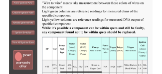

I am new to this forum and self-taught/new with outboard repairs. Last year I replaced both ignition coils on my Evinrude when I found that one cylinder wasn't firing (spark plugs were new and one was consistently not getting spark). After I replaced the coils (with BRP coils), both cylinders were firing and the motor worked great for about 2 months. Then the same cylinder seemed to quit (while running, I got shocked after touching the boot of the non-firing spark plug). I took the multi-meter to the motor this spring and found that the spark-plug leads were good, but both coils had output resistance that was below what I found posted for spec (supposed to be 200-400ohms but found one to be 12 ohms and the other, bad coil, to be 6 ohms). The resistance on the primaries for the coils seemed to be good (1.1 ohms each). I couldn't figure out how to test the trigger or stator on my model of Evinrude, but I found that when I switched the connections from the magneto to the coils, the same coil was consistently bad, which I believe means that the problem is isolated to the coil. And I should specify, the low coil resistances were measured when the coils were off the motor.
My questions are:
1) why would my new coil resistances be below spec?
2) why is one coil half the resistance of the other?
3) what would cause a new coil to die within a few months?

I would remove the coils and test primary and secondaries if the secondaries test OK at 200-400 ohms and you then get 6-12 ohms mounted....... the coil secondaries may be shorted internally to mounting bolts or punched or have burned the coil body which ends up touching the engine frame

Thanks for the reply! I should have specified, that the coils tested 12 and 6 when off the motor.
