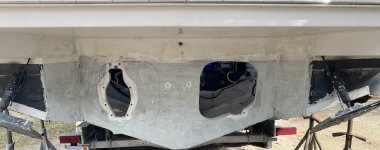

Flatness has been achieved . . .
I mixed up the goop (assorted fiberglass stands, VE resin, adhesive filler) and used the 1" Coosa pieces to form a flat surface. Clamped in place and heated for curing.
I'll need to do some finishing/fairing around the edges. but the engine mount surfaces are flat.

Remind me again, what will cover the holes up top or are you just taking bets on broken ankles?

I tried my hand at the VE fairing compound . . . It is a work in progress.
I'm not sure I have the patience to do fairing compound, but we'll see.
I got a final reading on the transom thickness, now that I have given them flatness.
IMG_9391.JPG.
No worries there . . . I just wouldn't want to be the one who has to drill the mounting studs . . . :ROFLMAO:

I did some cutting of the transom today . . . Went through a bunch of saw blades, metal cutting and carbide for the most part.
The transom is 2.00 " thick
about 1.5" foam core
0.4" fiberglass outer skin
0.1" fiberglass inner skin
I got to see if I can get some more blades tomorrow to do the other side.

Transom holes are done.
I also drilled the drainage holes that will let bilge water flow to the extension bracket where there will be a garboard plug.
The 4 holes on the underside of the swim deck are next . . . but . . . there is a vent tube in the way. That will be tomorrow's project, after we deal with car fixing. The Admiral's car is going in for a recall and my car is getting 4 new tires as per my flat tire post from last Friday.
