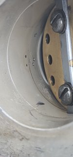

What are these 5 holes for? Looks like idle air circuit but I cant get anything to blow thru it.

alldodge
Mar 8, 2009
42,201
Don't know for sure but are in the right place for the venturi
