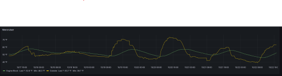

Every year there is inevitably a couple of threads of 'how cold is too cold'... I'm going to find out this year!
I winterized my 4.3l last week, and although I'm a firm believer in the air-don't-freeze method, the amount of water left over in the valley under the thermostat is always concerning. After draining/poking, I always pull the thermostat and dump a decent amount of -100 AF in there.
Being an IoT/automation tinkerer, I have plenty of sensors of all sorts laying around, so there is now a waterproof temp probe submerged in the antifreeze in the valley. In theory, as soon as that drops to under 32 or so, any water in an improperly winterized block is going to be turning solid fairly quickly.
As of right now, the block is nice and warm (relatively), but within a week the forecast shows nighttime lows in the low teens and a day with daytime highs in the 20's. As a FYI, the boat is stored in a stick built garage with metal roof/siding, no insulation. The boat is a 21' Hurricane deck boat, the doghouse is propped open slightly. The outside weather temp is from a weather station about 100' away from the garage.
Any bets as to how low or long of an outside temp to get the block down to 32?

Cool experiment. What sensors and software are you using?
An ambient weather station with a couple wireless Ambient sensors. I use a raspberry pi with a TV Tuner USB running SDR (rtl_433) to grab that signal over the air and then send it to a cloud server via MQTT, which Telegraph grabs and dumps into InfluxDB, finally to be graphed by Grafana. I use arduino's and ESP32's to do the same with other sensors. (like well water pressure, temperature, bbq/smoker, etc)

Takes way longer to freeze than I would have thought. 10 hours under 32 degrees, the block is at 37 but dropping.
(Also it is way more depressing to visually see mid 70's 5 days ago, and now we aren't going to get above freezing as the daytime high!)

wait until ambient air in the garage falls to 20 and you will see your block temp drop quicker. right now your still at 25ish with an 37 degree block. you have a thermal mass of iron in the 400# range. knowing that ductile iron has a k factor of about 70, you should be able to calculate the temperature drop. now things like if your hatch is open or closed will change the thermal conductivity on the air side.

Experiment over, block is officially 'frozen'. I am honestly surprised, it took almost exactly 24 hours of sub freezing temp for the block to get low enough to freeze water. As Scott mentioned, there is a pretty substantial thermal mass that needs to change temp, and that takes either time or really cold temps.
Obviously, results are going to vary with all kinds of variables (wind, temperature, storage building, boat, etc...), but this does give me a little piece of mind for those early/late season dips into freezing. Even a couple hours overnight down to ~20 is definitely not going to freeze it if it warms up during the day.
Now I'm off to move some more snow and dream about boating!
