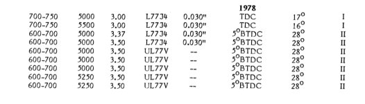

Idle is good. Idle set with motor in gear. Pickup timing is 5°. Full advance timing 28°.

I am assuming you picked up that I was setting the time using the Joe Reeves method that calls for 4° less than book value. To be clear, I don’t know squat about outboards so I’m not questioning you just ensuring you have the proper info. You say 28 I’ll go 28.

Joe reeves method requires you subtract 4 degrees. Do not deviate from that. You do not care about idle timing at all. Idle speed will be set in the lake in gear and warm.
Roger. I’ll put it back to 24°.
