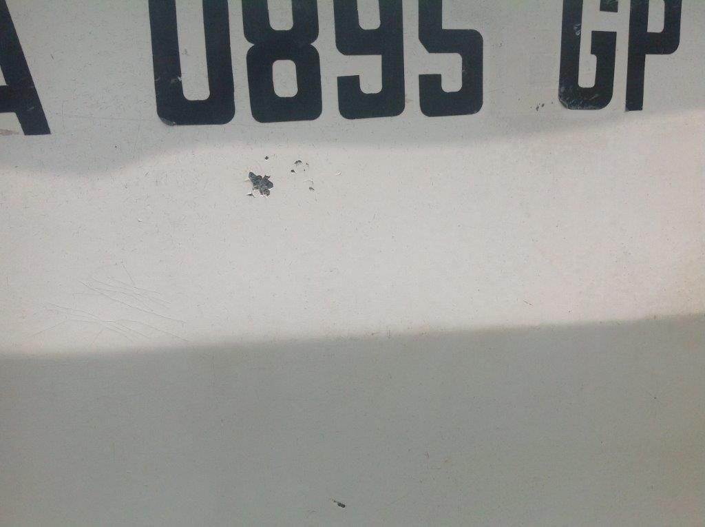

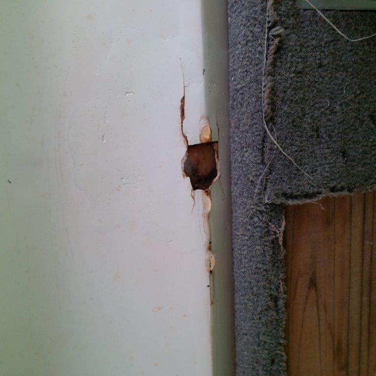

Now, I'm beginning to learn a little and I've looked over the hull and it needs some repairs. I don't know how significant, or how bad of condition the hull is in. There are several things that I see (photos attached).
1. There are lots of stress cracks (I think that is what they are) all over the boat.
2. There is a large hole in the hull, by large I mean probably 2 inches by 3 inches. The beige coat is gone but I feel what I think is resin or fiberglass, smooth as could be.
3. The previous owner put in new plywood (I know it wasn't done right) and appears to have put screws through the hull in a couple of places.

Hole in hull

Screw through hull

Your boat was dirt cheap because it needs a lot of work.
In all honesty, there's not that much short of a full restoration that's going to make that boat safe and seaworthy. Your boat has been neglected and in a state of disrepair for quite a while, and this means your below deck structural support is way more than likely rotten.
The hole in the hull needs to be repaired from the inside, trying to repair a hole in the hull that large from the outside will be futile.

The repair to the hole in the hull will require access to the inside for a proper fix...
Unfortunately, that isn't always possible without some demolition to get to it...
And, usually when this is done, is when you will begin to see the full extent of the repairs needed...

From what I can see the hole is from a previous patch that was not done correctly. Screw Holes will be an easy fix. Have you jumped up and down on the lower leg of the motor to see if the transom flexes? If it does then the transom is bad and will need to be replaced too. Deck, Transom, Stringers is a full restoration and you can expect around $1,000 to $1,500 in costs and 100-200 hrs of time. Your carpentry skill will be a + and glassing we can teach you how. Now it's just a matter of if you think it's worth it and if you want to put forth the time, effort and dollars to do the job. When You're done you'll have a really good boat that will last a long time. How's the motor? Start and run Good? Have you done a compression check on it? If not I would recommend you get it done. If all cylinders are above 120 then it should be a good one. If you like the style and layout of the boat then I'd say go for it.
