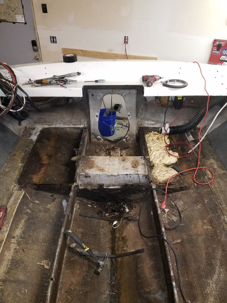

I dont know if pics are uploading correctly. If they do ya guys let me know whatbya think..... anyone seen a boat that looks like this before? I havent but thought it looked pretty cool for an 89

Seen a few of them arround, good looking hulls to me. Looks newer. I can see your interest in rebuilding it.

Yea, i dont have much in it and cant really afford a new one lol!!! It was depressing to see rotten stringers and transom but im no stranger to hard work. I dont know much about volvo drives either. However mine seems to work very well. Can any one see more than just the 1 pic? Forgive me im new to the posting pics thing

It linked me to your photo bucket account. Volvos are good drives that have support. Many were used to push houseboats.

Most take measurements before they cut out much. Accross the boat in multiple places. Make sure the hull is supported well, mine was just the trailer bunks and it hasn't had any issues. Remove both srtingers and bulkheads. Grind back untill you have raw fiberglass with no gelcoat. Many different approaches to do it. But on yout boat or any untouched poly boat I would just use poly. Your boat was built with it and it will preform wellfor your purpose. Make sure you check your transoms well. You have 3 diffrent parts to it. Much easier to replace as you only have to do the bad sections.

I hope the trailer bunks will support it. I did take lots of measurements and lots of pics. As for the transom its kind of an odd design, only the center section has any wood in it.

The sides should have to. That is what your trim pump screws into. It is simular to the one in my Bayliner. Much easier than pulling the cap off of the boat to replace. If you have full length bunks you should be fine.
