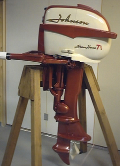

Here in British Columbia Canada, the government is leaning towards banning the older 2 strokes on our fresh waters in the future.
Those bans will never apply to existing motors.
I'd like to see them telling this taxpaying voter he has to throw his fishing buddy in the scrap bin:
Bans will only ever be on the sale and registration and even that will likely never happen out there.
