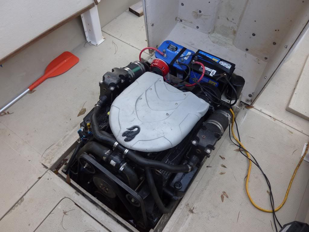

I'm pretty sure that upper starboard side pulley provides the tension. The bolt that holds it in place has a gear on the backside and it meshes with a toothed rack on the mount. The other end (threaded end) of the bolt has a hex (5/16" if memory serves) forged into the end of it. Loosen the nut by the pulley bearing and the bolt will turn relieving tension.
