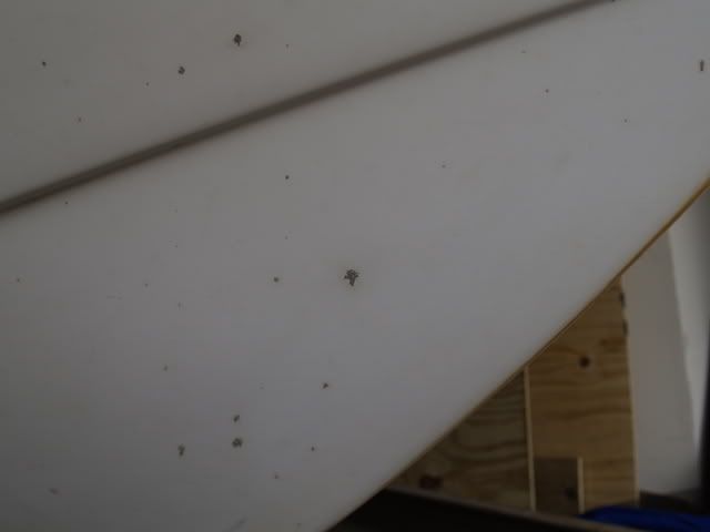

Here's one fur ya. How would you suggest going about removing concrete splatter from gelcoat? I assume the previous owner was mixing some concrete a little too close to the boat at one point. I've purchased some Dupont 606s compound and am getting ready to clean up my hull, but am perplexed as how to remove this. Thoughts?

Try a plastic ice scraper first and be gentle, if that doesn't do the job, try some muriatic acid mixed 50/50 with water. Wear gloves and other protective gear when using the acid.
Rinse well with water immediately after the acid treatment.

maybe something that removes calcium build up on faucets, like CLR, would work. I am not sure how you would be able to soak the spots. but anything that attacks calcium carbonate would work.

I had an aluminum boat that had the same problem, only a lot worse. It looked like they dropped a bag of Quickcrete on the hull and let it get rained on.
There were 4" sections covered in thin concrete. I tried everything, the only thing that worked as to take a sharp edge and lots of water and chip it off at a sharp angle. It came off with little to no noticeable damage but took several hours. There's not much that will dissolve concrete. If you lucky, it wasn't a thorough mix and may not be fully bonded.
The key is lots of lube and keep flushing away what you have already broken free so as not to scratch the surface.

Acid based compounds remove the calcium and breakdown concrete. That is why they use muriatic acid to whiten concrete.

WD40 didn't work, although amusing. Plastic scraper didn't work. I couldn't bang from the inside with a rubber mallet, but did bang aroundish it. Only thing that did was leave black marks. I let some compound sit on there for quite a spell and it seemed to loosen it up a bit, but couldn't tell for sure.
In the end I found a screw driver & large allen wrench worked best. I liked the allen wrench, because it's workable without sharp corners. I was super careful and didn't leave any lasting marks. I'm not so sure I'd try this on a high dollar rig, but mine is 20+ year old. I'm gonna try to get my boat on the water for a test run tomorrow and after that I may try the high power car wash.
