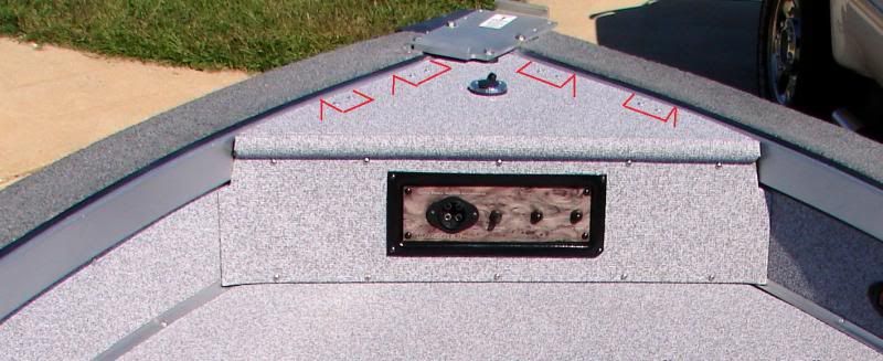

I found this pic on the site. This isn't my actual boat, but this is the exact same configuration that I have to work with. The next after building a bow platform, my next project is going to be a casting platform using the bench seat and the space in front of the bench seat.

Re: How to build a bow mount trolling motor platform on a utility boat ?
I think you should take the boat out a few times and verify the stability before you start thinking casting platforms. With a life jacket on, try standing on that front seat. Expect to get wet.
Now your troller platform would look best if you took the time to carefully shape a piece of plywood to tuck under the rail and the existing bow cap. You could work with scissors and poster board to make a template and then trace it to your wood.

As far putting the bow mount platform under the rail, how would I then attach it?
Aluminum boat deck framing is really quite simple, but it does elude quite a few people. Aluminum boat deck framing is best done with aluminum angle or square tube and rivets.
Look at your boat, see all of those rivets holding it together? There's a reason for that, they're the best fastening method for aluminum and have been used for many decades.
You don't have to use the solid rivets that take 2 people to install. You can use the closed end blind rivets that're much easier to install and only take one person... like this:
1989 Sylvan Boat Rebuild Part 4 - YouTube
Framing with aluminum is light weight (very important with small boats), very strong, and permenant because it will never rot or decay.

I hate to mix metals so I would buy some AL angle stock at the BORG, make myself some small angles for it to rest upon and rivet it in place as suggested above. Also adding a couple of SS screws down through the box cap and into the wood.
