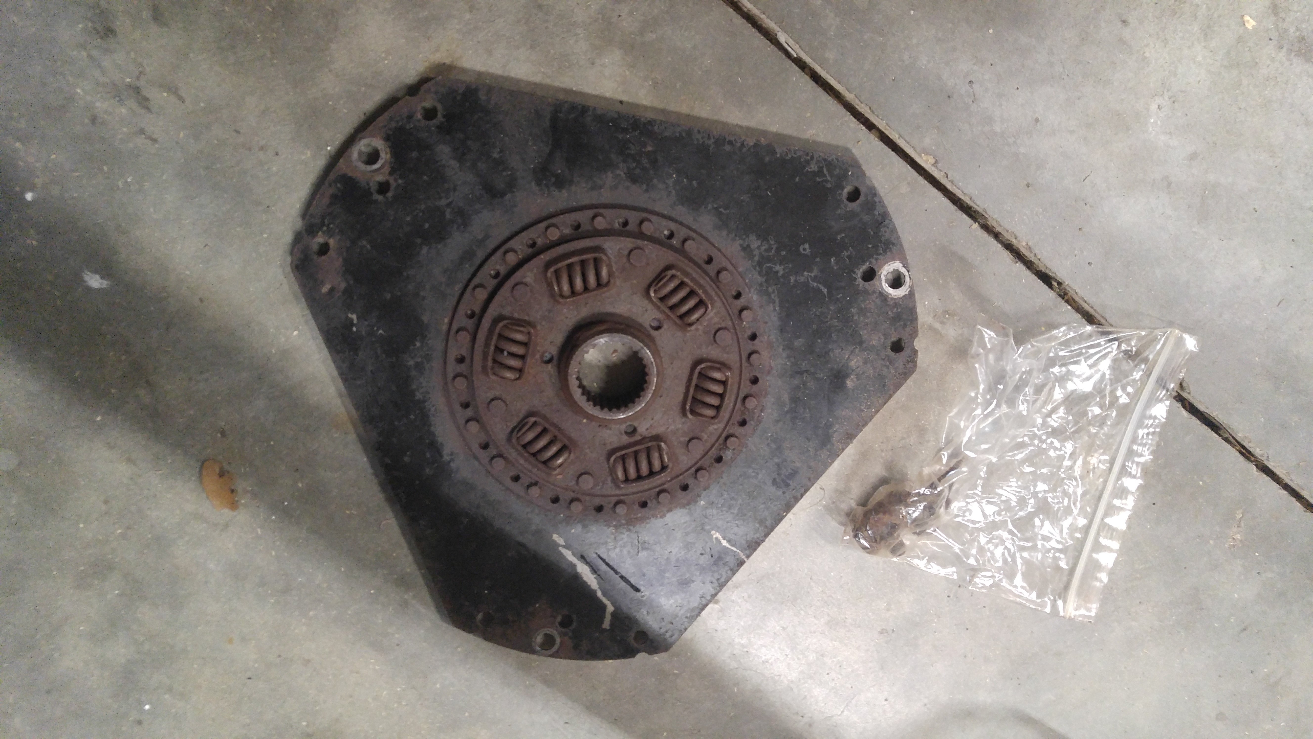

The outer bolts I am referring to is the ones closer tk the outer diameter of the flexplate. The ones you would use to bold up a clutch to. Thanks
53,253
yes, however only 3 of the holes on a small block. 6 holes on a big block
53,253
your drive plate should look almost exactly like this, except 10 splines vs 26
full
Amazing!! Thank you very much. So in theory I could drill and tap any flywheel for this bolt pattern, fab up some motor mounts and install multiple different motors. Interesting.
-So my intermediate has 10 splines?
-could I purchase a driveplate for different motors that would adapt it to my 10 spine shaft?
Thanks again
