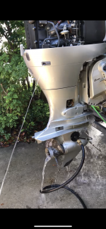

Yes my buddy is doing the work im assisting im a electrician by trade he went to boat Mech school years ago but is not in the feild currently but the thermostat didn’t really have a lot of scale or anything. Wish I would have taken a photo before throwing away. Pisser is pissing good. I should add it will only alarm when it’s in gear.

It appears to be mounted on a toon. Since it sat in water check to see if center water deflector between toons has varmint's that could deflect or cause air into water flow
