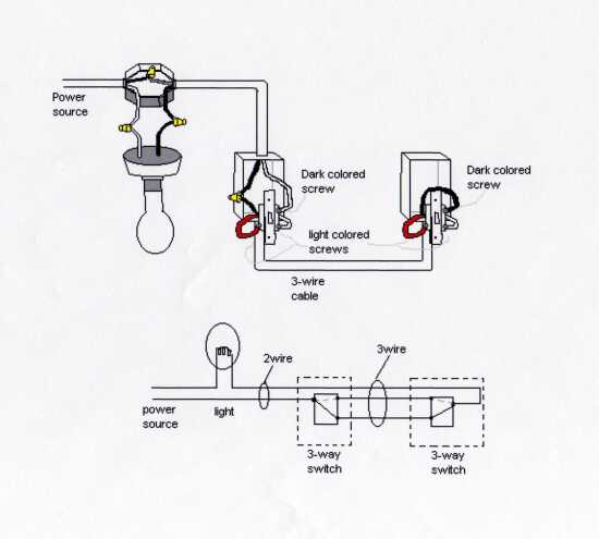

Yes, but it is the multi switches were you have to reverse something??? so that each switch will turn the light off and on (it has been a few years)
OK, who's got the diagram??
No.
You never switch grounds or neutral.
Basically a 3 way switch is a single pole double throw switch. The two switches are wired up so that the double throws are wired to the double throws on trhe other switch. The hot is connected to the common of one switch and the load is connected to the commom of the load.
Do you have the diagram some place???
I would like to see how it is done as it has been a quite a few years since I learned this stuff.
Here is one.

Thanks Bruce.
Still get this stuff mixed up as I do tel cabling for the most part, and have not done this stuff since the labs in school.
