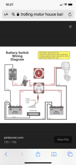

The blue seas switch and acr method seems to be what I’d like to do but what if I have a 24v trolling motor? Do I need two more batteries? If I have a 12v trolling motor would it be ok to run the house fuse panel and 12v trolling motor off the same battery?

If you currently have 1 battery...I'd add 1.
lol. Yes, I only have a cranking battery at this time. I was gonna buy a battery for the house wires (which I still have to figure out). I was wondering if I bought a trolling motor and it was 12v can I run it off the same battery as the house circuits. Also, if I buy a 24v trolling motor do I need to buy three batteries? One for house circuit 12v and two for trolling motor 24v???

The reason I ask about the amount of batteries is because a purchased an onboard dual battery charger to maintain my cranking battery while I was working on the boat. However, during my research about boat wiring I’ve discovered that this 17ft boat is boarder line between a 55 thrust trolling motor and something bigger. If it needs more than 55 thrust my understanding is that I will need a 24v trolling motor battery vs just a 12v trolling motor. I wanted to save my cranking battery for the motor and have separate wires for the house battery and trolling motor. If it was just 12v then the house battery would be shared with the trolling motor, but if the trolling motor requires 24v then…
Do I need one battery for cranking, one for house fuse panel (12v). And two more for a 24v trolling motor?
