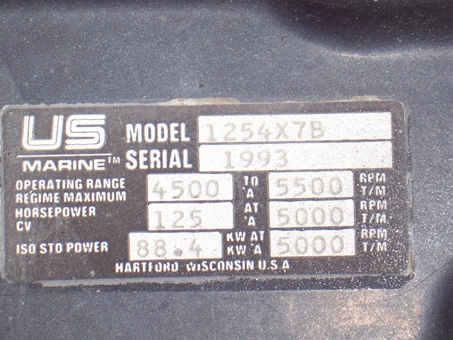

redfury
Jul 16, 2006
2,659
Re: Help with new buy!
This is what the ID plate looks like on my motor, it's on the port side ( left ) of the motor...opposite the T-N-T cylinder
jerryjerry05
May 7, 2008
18,196
REDFURY That sticker is somethinmg almost all older Forces don't have.It falls off.Your lucky.
The a/b/c on the sticker is for minor changes in the motor and trim systems.
The stator and trim motor on some have different connectors and the a/b/c/ denotes those changes.Along with a lot of small things.
