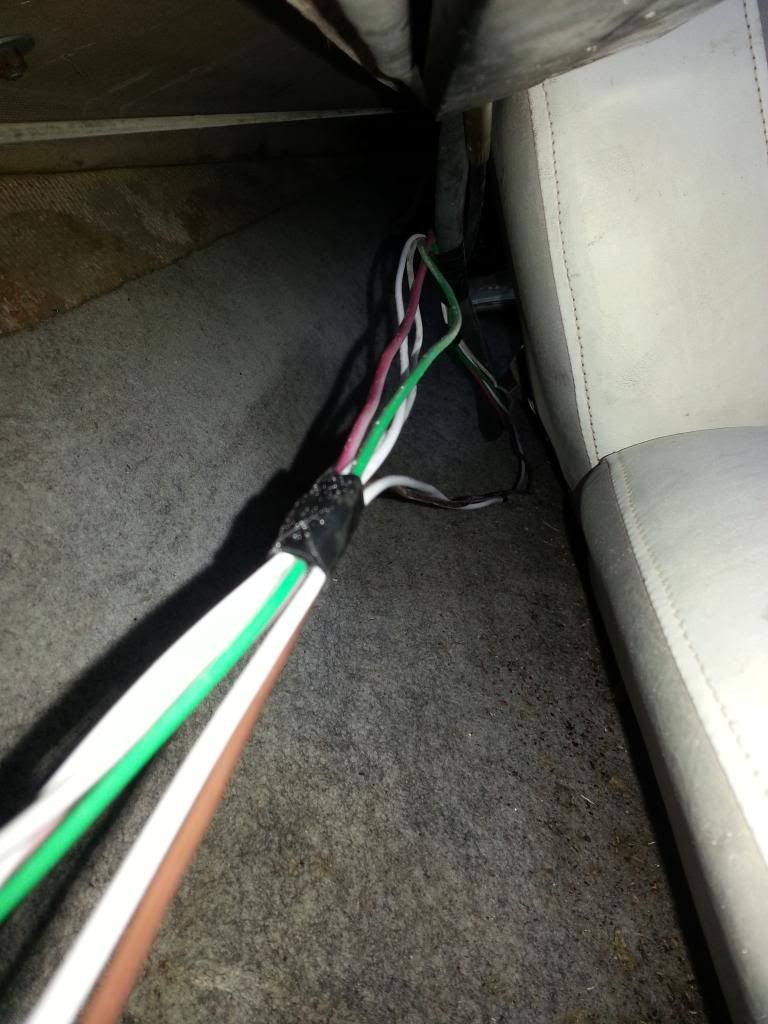

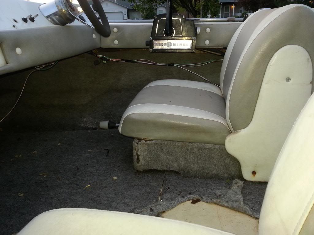

The floor of the boat is very solid and crawling under it the underside looks good for 51 years old. I completed the wiring of the lights and the bilge pump. I just need to finish securing the harness.

Hey that's good, no soft spots in the deck. Check and see if someone has added a 2nd deck over the top of the original one. If everythings good then you'll be in for a re-carpet job.
