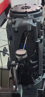

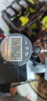

1986. You guys hooked me up. I went back and tried to align the rust/stain marks. Worked and both 0 and .464 line up. Flywheel was both put on loose and wrong last time it went for maintenance.
Now I wait for the new puller and holder and will do all the swaps. Will result in a completely new ignition system from key to spark plug.
