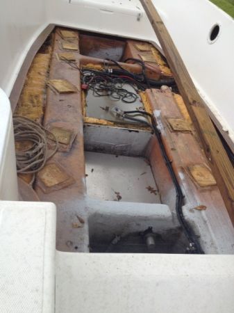

Looks like your floor is part of the deck. Its a whole part molded just like the hull and then attached to the hull. As such it may not touch the stringers and be a free supporting floor built with a cored construction like balsa, maybe. Some pictures of the whole boat will help. Just thinking that you have some rotten core in the deck floor and from a nut and washer pulled into the inside of the transom maybe a rotten transom as well. You need to drill some small holes into the transom and deck floor and see what comes out. Dry wood or wet black mushy wood.

Yes, it's got a yamaha 150 2 stroke outboard on it. I'm not 100% sure about the transom...I tried jumping on the motor to get it to flex, but haven't had any luck. Before I start drilling into to see of the wood is rotten, is there some kind of test I can do? Maybe tapping with a hammer or something to try and locate rotten wood.
On a different note, I drilled a small hole in the floor near and soft soft, I confirmed water in the wood. I then removed a the housing and found wood so rotten that I could remove it with my finger. It does appear to be a layer of gel coat/fiber glass then the wood, then more fiber glass. So replacing the wood shouldn't be as big as project as I thought. Any suggestions on what type of wood and fiber glass I should look into buying?

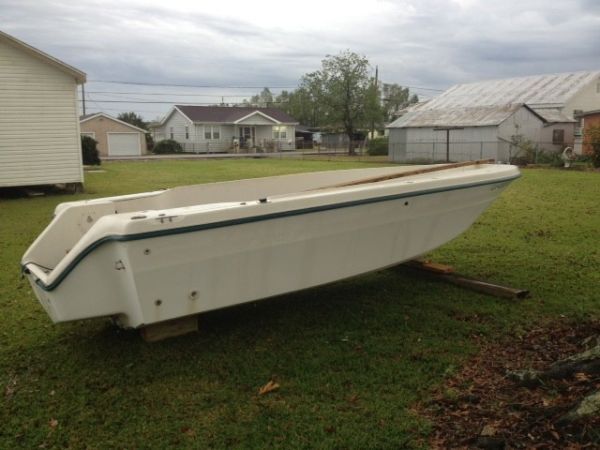

Can you post some pics of the entire boat, both inside and out so we can give you more educated answers???

Sorry for the delay, we are in the middle of a three phase company move! oh the joys!! (dont mind the seat saying blazer bay, the person that i bought it from had it installed. its actually a Century).
here are some more pictures of the whole boat and the area that needs repairs. I stopped by a local shop today just to talk with the owner about the repairs, he is guessing $1200 for the supplies and about 4-5 weeks worth of work? doesnt sound right to me. Let me know your thoughts and if you need more pictures or anything.

You surely have a wet transom core. It's a laminate wood between 2 fiberglass panels. Things don't push or pull in (creating the recessed spots around bolts) unless the core has compressed, normally from rotting around bolt areas (improperly installed). Could just be a bit of rot around bolts (surely) but probably the core is wet too, it could go many years that way though. But there does seem to be the usual stress cracks which would tend to indicate you have soft areas up top as well. They don't look too bad though, if there's no movement when running you could go awhile like that.
Though not bad...the transom wood is only in that extended square section in back the motor mounts to, not where the drain plug is or the sides (ladder,etc) or the various accessories, those are likely in solid glass. Those aren't like flat backs where the whole back is wood laminate. I just did a transom on a similar setup.
But likely ends of stringers will be wet too. As builders lay a wood frame, then glass over. Wet in one area travels to an adjacent area. If the stringers seem solidly glassed you could theoretically replace from the outside, if they seem not heavily glassed you'd better get it repaired from the well side so the ends of the stringers can be examined. There will likely be knee braces in there as well.
