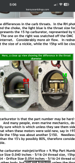

Carburetor comparison: look inside the throat and difference is obvious. A 9.9-HP carburetor throat measures 0.625-inch and the 15-HP carburetor throat measures 0.875-inch. There were three difference carburetors offered over the model years (early, mid, and late model production)

Judging by these photos from Leeroy’s Ramblings, this seems to be a 15hp carb. Hopefully it is because that was my intention for this motor to begin with but I did not realize how much these old carburetor’s sell for on the web!

Left 9.9
Right 15
img_1175-jpeg.394611
