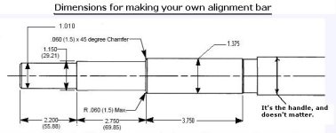

A 1 inch dowel rod may close but it's not within spec (note tolerances)
If coupler is warped you can rotate the engine 90* and there will be a difference in direction
You need a true alignment bar

I have a true alignment bar (and I use this to install the bearing as well). It fits in very tight and when I turn by hand it is not smooth/ feels like it binds up. When I stared the motor with the alignment tool in it causes the vibration. No vibration if I remove the alignment bar.
