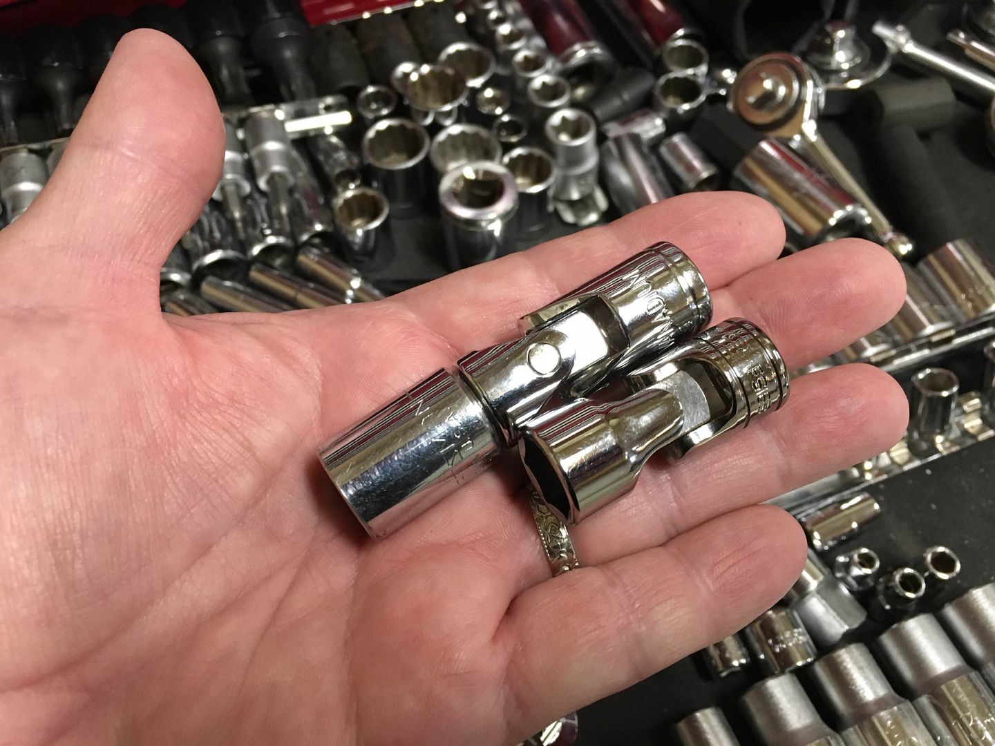

For torque and re-torque of the port head, I bought a 1/2" 6 point shallow swivel socket. Much shorter than a universal joint and socket, allowing access and fairly close torque setting:

what brand is the swivel socket ? Where did you get it ?
It's a Snap-On. My neighbor is a dealer and I got it for a reasonable price, but you could probably buy a full set of cheapies for what it cost.
