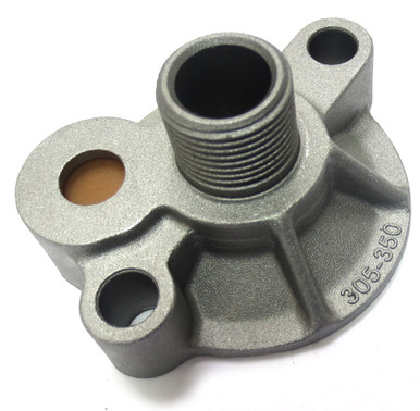

Hello all, I want to install a remote oil filter mount for my 4.3 V6, is it neccessary to replace the filter mount bypass valve?

Just a follow up on this topic I found out the block adaptor in the kit I got from Michigan Motorz was made by Canton Racing in Ct. So I called their tech line and asked the question of whether change the bypass valve. They said I could change the bypass valve to the 30 psi unit, or use their custom oil filter mount adapter that eliminates the bypass valve, but make sure to use a filter with a bypass. The filter supplied with the kit is a Wix that does have a bypass (its the large Ford/Chrysler filter). So I guess I could do either, any preferences to doing one or the other?

I found out (and I THOUGHT this was the case) that the 4.3 is different than the small block V8s. It does not use the removable adapter with 2 bolts and the bypass staked into the adapter. The stud for the filter is threaded right into the block and the bypass is staked right into the block. So due to the location of the bypass it would be pretty difficult to remove with the engine in the boat. Might just install it as is, and as per Michigan Motorz advice and see if the filter gets warm like it should. If so I'm not going to worry about it.

Adding this for any V6 owners who want to add the filter mount. As you can see in this pic, on the smaller 4.3 mounting pad, there is no added bypass housing. That housing would not fit, it would have been a lot easier if they were the same but they aren't.
So the only way you are going to change one of these out, is to have the engine on a stand, no way you can access this well enough to not mess this job up with the engine in the boat. I may just hold off on the remote filter mount till I repower it and do it the right way.

take threaded bolt (I believe 7/16" and shove up in valve, work back and forth pulling down.
make mess in bilge
stand on head and drive in new valve
drink beer.
