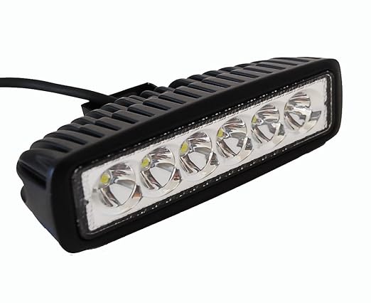

I was looking at LEDs and found some nice ones (small) for about $70 bucks. These:
Nice but at $70 I was looking at $140 and these were $40 for 3. My guess is I could CL them for a more.
jc55
Nov 3, 2006
665
Re: HELLA Marine lights
I bought those in black for $19 each. What's happening is that LED's are big money. There is an offshore manufacturer under selling everyone so bad, that vendors are buying it, doubling the price and reselling. The $19 lights I bought a month ago are now $23.90 each.(I won't give the vendor and violate iboats policy) I replaced a rear deck 55w halogen with one. I have it on a switch, the alarm unlock lights it for 30 seconds and it flashes when the alarm is triggered.
It's also a solid, heavy aluminum casting. Pretty unbelievable actually.
