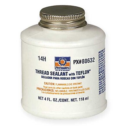

OK great thanks. So the manual specifically says Perfect Seal on the bolt threads, but you'd suggest using something else? When you say sealant, something like 3M 5200?

You don't want to use 5200 due to it's more of a permanent sealant and not designed for this situation.
The sealants to use would be something more like the ones linked below for example,
Permatex head bolt sealant w/Teflon, http://www.permatex.com/products-2/p...sealant-detail

Clean thread holes out with plumbers wire brush
In the old days they specified oil or grease. Then they went to antisieze. I use ARP sealant which is antisieze and grease kind of mix. Pulled a Merc reman apart and found something which looked like sort of silicone. Called Merc and they said it was Permatex
