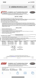

I traced these steps. Whenever I unhook the rectifier, she starts right up and runs but if I hook it back up, she gets no spark. Model E70TLEDA
