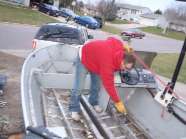

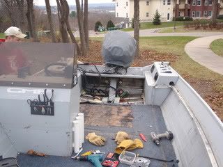

Well its been way too long since I've posted an update. I've spent more time reading on here than I have working on the boat!! Since my last post the motor has been pulled. The foam, stringers, and every single piece of wood had been pulled as well. All the loose rivets were bucked and not a drop comes through now. My transom was water soaked and was home to a family of termites.(I made $1.83 in change that I found under the deck!) I received my Gluvit in the mail the other day and tomorrow that goes on. I've scrubbed and degreased the hull and used 100 grit paper to lightly rough up the areas that I'm coating. I'll be laying pink foam once the Gluvit cures. After that comes the wood decking. This is where I have a few questions.
How much epoxy resin do you guys estimate it will take to coat both top and bottom of the deck as well as the transom? (Boat is 16ft, transom is roughly 72x18x2in)
I plan on using the US Composite Brand with the Medium hardener.
Thanks for the input guys!!
(Pictures finally!! These are from gutting day)

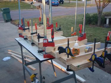

Another productive day today. Gluvit was applied to all seams and rivets in the boat so lets hope that keeps the hull dry. While that was curing I went and picked up the wood for the new transom. I was able to squeeze the 3/4in pieces out of one sheet of ply wood. I used (2) 3/4in pieces and (1) 1/2in piece. Pieces were cut to a managable size and then Gorilla Glued together, followed by lots of clamps.
Once that dries up I'll drop it back in to drill holes and cut off the excess. I hope to get my Expoy resin ordered some time this week.

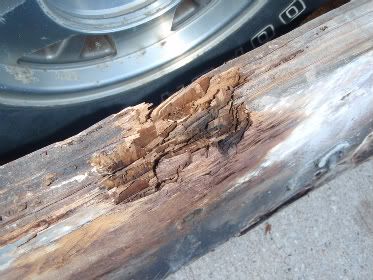

Thought I'd post a couple of pics of my old transom (aka Termite Hotel)

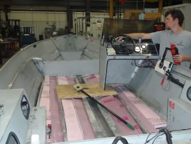

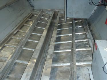

Back at it today. The Gluvit was cured and I am very impressed with it. We started the day my replacing the stingers that were pulled in the gutting process. These were riveted back in place and are much more secure than they were when we pulled the deck.
Here's the stringers back in place
After those were back in place. We went to Menards and picked up the pink extruded polystyrene. The foam here is fair priced and I paid $50 for (2) 2" sheets, (1) 1" sheet and (1) 1/2" sheet. All sheets were 4'X8'. I used almost all of the 2", most of the 1" and didn't even touch the 1/2". I found the cutting and shaping to be a big pain in the rear but we got it done. Its not pretty but its in there.

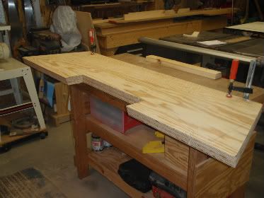

My brother (who is my partner in crime for this restore) and swung by my dads wood shop where the transom is being stored, and found that he had already began to shape the transom A few more cuts then it'll be ready for hole drilling and epoxy. My dad is a master wood worker so I trust him doing it more that I do myself. We're going to drop it in tomorrow night and mark where the holes need to be drilled.
