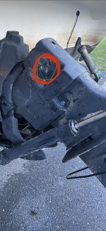

I pulled the boat today and do not hear the noise out of water
Put your fingers inside the gimble bearing and rotate it. See if it feels a smooth as silk with no roughness
Szaszing
Apr 7, 2021
24
The one circled ?
