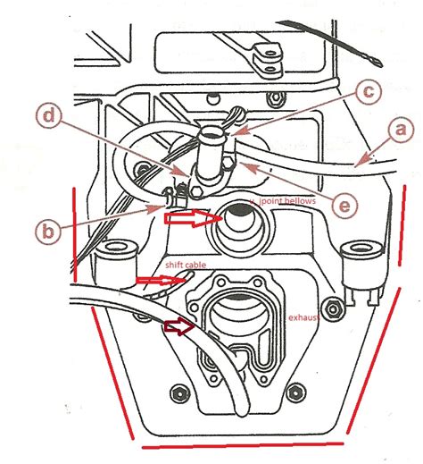

Being an 3.0L engine/Alpha application yours may or may not have had an oil hose fitting installed form new as it was sometimes an option to have it in the earlier years but should it be there or someone fully installed the oil system then at the rear of the middle area of the transom assembly ought to be a fitting that looks like item 5 attached to item 1 of the following parts diagram, https://www.mercruiserparts.com/bam/subassembly/30860/1942/230
And/or at placement B_8

should have a nipple for the hose seen here not sure why the pic is rotated F35BE3EF-6E7B-4536-BB5A-05D89B25A4FB.jpeg
