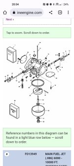

Are you sure the little passages in the brass bolts which hold the float bowls on are not clogged?
Maus01
Aug 15, 2023
65
Nr 20??

Lastly, check the setting of the idle mixture screw (fuel air mixture screw) #29 on carb diagram. Make sure it is 1 1/2 turn out from slightly seated on each carb. This action means you would screw in the mixture screw all the way in (slowly to avoid damaging the tip) lightly. Then turn it back out 1.5 turns out and leave it set it there.
