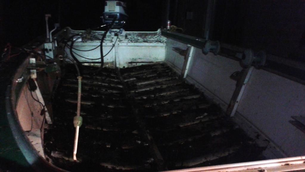

Here's the boat mostly gutted, sorry about the poor lighting.
Woodonglass
Dec 29, 2009
25,932
She's got nice Bones!!! The Pink Slab foam works really well.as do the Noodles. Gluvit is a Great Insurance policy. What size/yr/mfg is the motor?
