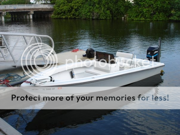

How she normally looks:

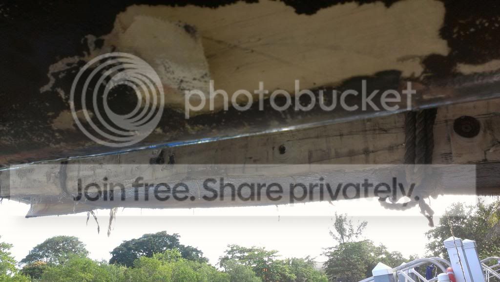

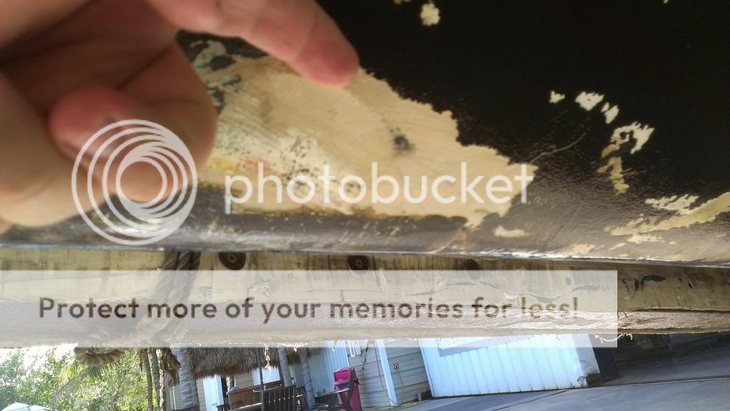

The primary hull issue, no clue what caused it. Have been told anything from submerged debris to bad patch work prior:
I have done as much research on this as possible via the web and talking to glass guys and suppliers. I was able to visit Fiberglass coatings inc. www.fgci.com at their showroom and one of the reps walked me through what was needed for the repair. Basically I will be using a gp polyester resin with 3 layers of chopped glass mat finished with new gel coat, hopefully this is as easy as the youtube videos make it look

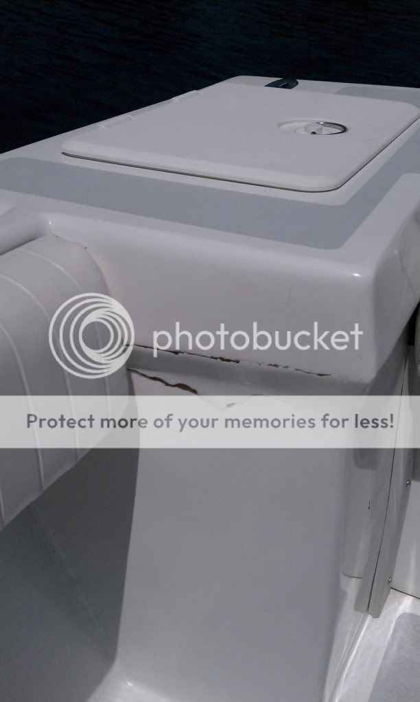

A secondary job I will start to tackle this weekend are some older spots where the gel coat busted and chasing a few spider cracks.
