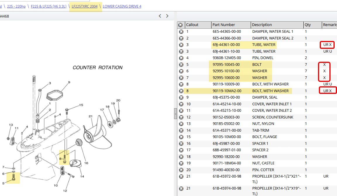

I have an 04' LF225TURC 225hp outboard. I am mounting my 30" outboard on a Grady White fisherman and it needs a shorter (25") unit length. I'm planning to change the mounting bolts and trim the water tube on the motor. I've searched many online parts breakdowns and have not seen any part numbers, or seen options to buy the bolts even on e bay, or shown on the mid-section options. I realize these bolts usually stay with motor but I'm sure this is a fairly common conversion.
Can anyone help with part numbers, or any online sources? Always appreciated..

It is all laid out for you in the applicable Yamaha parts catalog. For example
frustratedboater
Jul 10, 2007
505
I appreciate it. i didn't see it in my Seloc cat. I ended up finding them, thanks.
