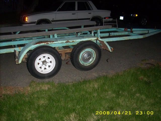

i think tha majority of the weight will be on the axels. 2 x 4500 lbs
so the axels will do it.....but i may need extra support on the tounge.

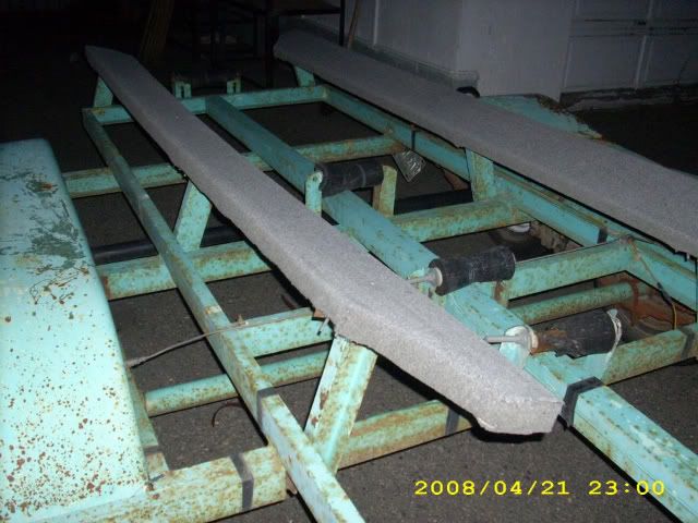

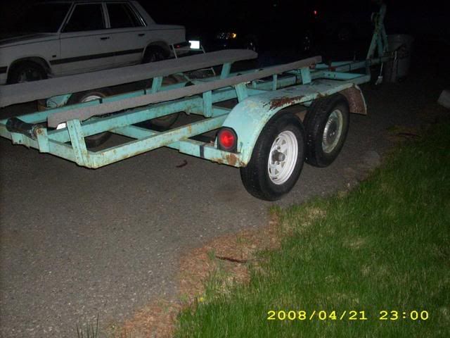

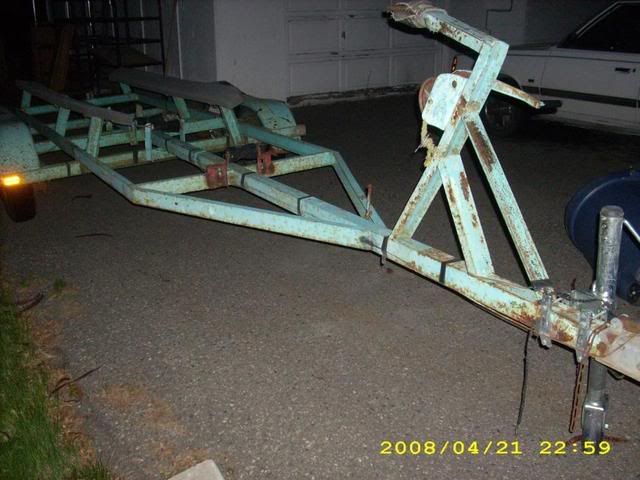

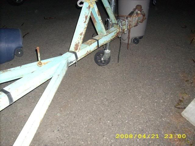

heres the pics....
just where the riser is for the hull lock is where im thinking of adding the strech.
if i add towards the rear it will be more work and materials
i want to loose the rollers in the center and just have a bunk style.....the center rollers rip up the keel..
i never power load...allways float on or off. the trailers so high ive gotta go far back into the water to load/unload
im going to have to add longer bunks. but thats no biggie...i think if i add a foot off the back (bunks) and a four foot section....the weight will be disperced evenly......
ideas/suggestions?

I have extended quite a few trailers by installing a longer tongue. Seems many people want to use the shortest trailer they can for a given boat. Makes it a pain when you try to open the tailgate or launch in shallow ramps. Instead of adding a piece to the current tongue, I cut the old tongue completely out, and put a whole new piece on. Much cleaner look to it, and it isn't a "patch." If you have to ad a lot of length, and you mentioned needing a bit of extra bracing, I would go with 3 x 4 instead of 3 x 3.
EDIT: Just saw that your tongue goes all the way back. I would cut it off where it meets the first 90 degree crossbar, and put 3 x 4 forward of that.
Ayuh,..... I'm inclined to Agree,....
I take it that the tounge is 3x3 box tubing now,..??
You could butt weld the tubes,+ carry the weld down onto the cross member with a 3x4,+ it'll be strong enough to go 6', 8', maybe even 10' longer(overall) than it is now.....
Then weld the winch stand back on where ever you wish,+ use the Extra long tounge for easier launching.....
I did darn near the same thing on my wagon,.... I took off a 4' long piece,+ put back a 10'er......

Leave the keel rollers,.... They'll protect the hull from the Cross Members....Just mount'm Low.....

5' is a lot to add and it tends to twist/flex without extra bracing. Flex can somewhat be dealt with by using heavier wall thickness to match existing tubes and framing but adding the longer boat up front with it may make too much tongue weight...and require moving axles fwd. A friend of mine extended his sailboat trailer from 28' to 32' and the tongue weight went from 500lbs to 950lbs carrying almost the same boat weight (6000lbs). Axles had to be moved to make it safe.

thought id show the picks of the semi finished project.
the bunks still need to be extended, wiring properly done, new fenders to be added....ect....ect
the axels will have to be moved forward, but to find the proper tounge weight, i need to have the boat finished and loaded...(motor....gas full ect)
the ideas here, worked well, after trailering the boat to its new temporary location, there was no issues at all. ....and it didnt even crack in half...:D
