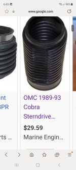

I replaced the bellows on my 2.3 and they are made with slits in them.

They have been like this since like the second year of production; the idea with the slits is to reduce back pressure at idle when in the water.
