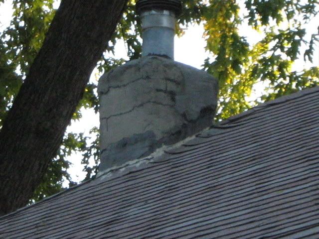

ain't pretty, but hopefully will keep the weather from attacking my house......the new concrete patch is in the upper right, the black lines is the black tar likes stuff i used to fill minor cracks....
contrary to the way that pic looks, everything is mostly flush.....

By looking at your picture, I am assuming you are burning an oil fired furnace ( I think I read that somewhere here) and the liner is good enough for that.

As long as the liner is secure the main concern would be appearance and tightness from water. Why not apply some backerboard (like that used behind tile showers to the outside and then put a nice stucko layer on the outside. Make sure that new flashing is covered to prevent water from coming in. Cost would be less than 100 bucks and an easy one day project. It would look like a new chimney.

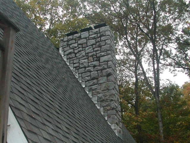

That chimney needs to have some stucco mesh wire put all the way around it and then stucco. It looks like it will hold for a while but if water gets in those cracks and freezes, it'll open right back up again. Definitly going to need some major attention in the near future. I can't make out if the chimney has step flashing and a counter flash in a riglet,, hard to tell. You should not have to seal the shingles to the chimney at all. It should be flashed somewhat like this photo.
it's just a regular natural gas furnace. was replaced with a 85% effecient in 85 or so, whatever year i got the house...
everything looked tight to me, and i filled every crack i could find so i'd be hopefully watertight....
yep, it may need further attn. in the near future. note though that this is the first time i did anything to it from the way i got it 20+ years ago. and nope, i didn't see any flashing like you have on your chimney......that's a little concerneing.
like i said. i was just trying to get it back to watertight. you sure have a good lookin chimney fh.......looks like it's on a very expensive house too......mine is on a 70k house (so the county assessor says). and i know nothing of how to repair a chimeny. i just did the best i could for my skill level. which is pretty low when it comes to stuff like this...... guess i'll have to try to put some bread back for chimeny repair in the future......as long as it don't eat into my boat repair funds.....a mans got to have his prioritys ya know.....:D
