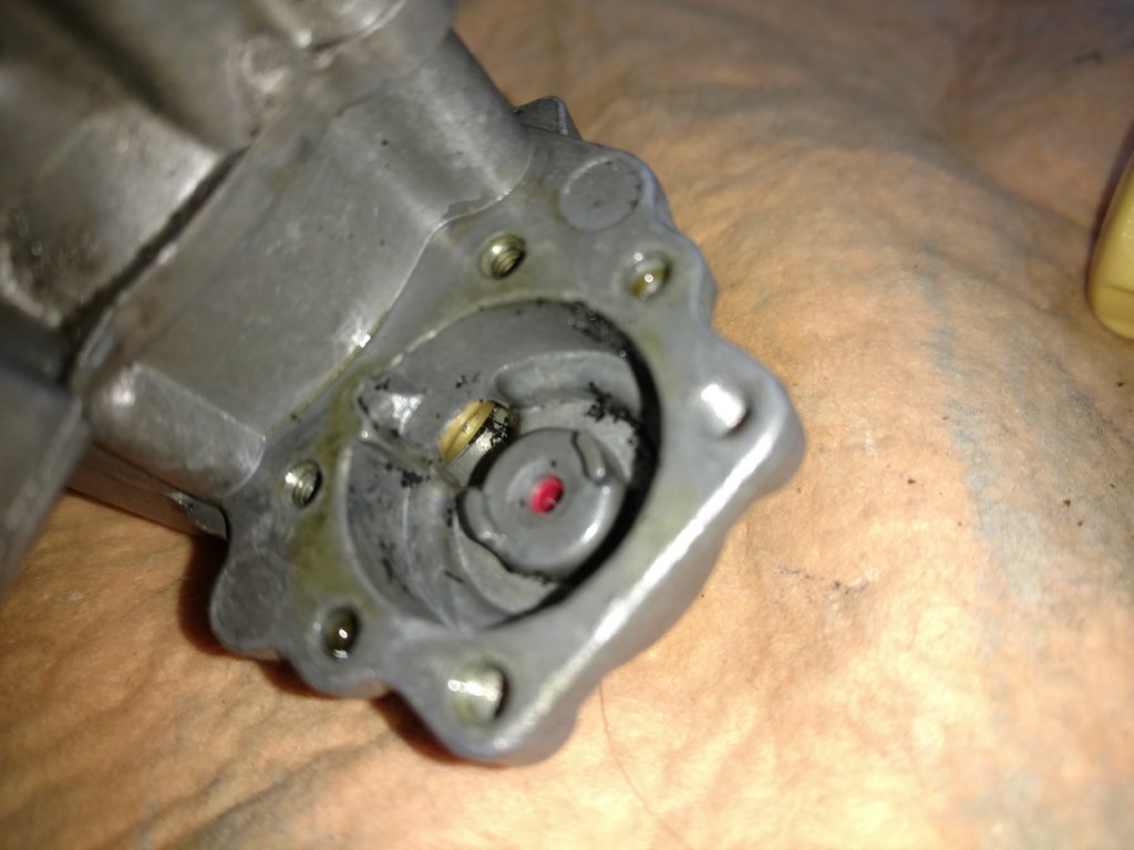

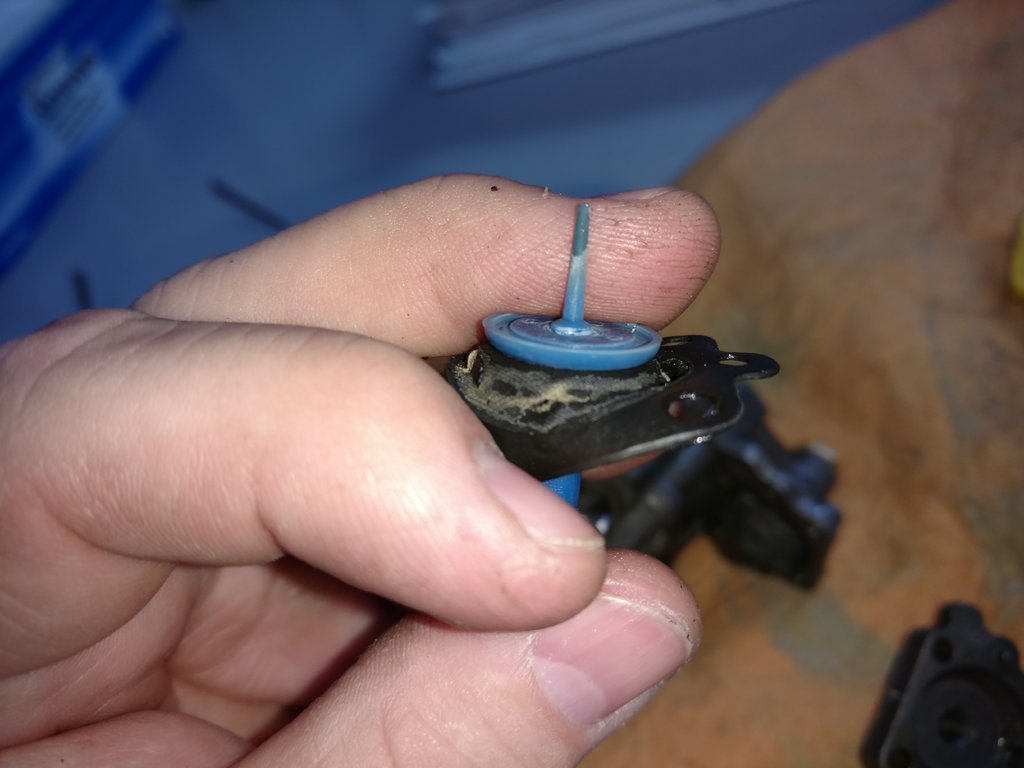

Is this the results of using ethanol laced gasoline?
This is the primer housing and primer diaphragm. The only thing left is the mesh like material that the rubber is bonded to.
Can I assume that the fuel pump diaphragms are going to suffer the same fate?
I just got this motor. It seems to run fine. I just noticed fuel blowing out the weep hole in the primer body when the enricher plunger was cycled.

could be, however most likely its because rubber has a finite life expectancy of under 15 years......and your motor if I recall is a 2000 making it 18 years old.
its called design life.
I would suggest replacing all rubber/plastic components as most will start failing

Make sure you replace the spring under the primer assembly and make sure the ball goes back in. You do not have valves or injectors and the fuel filter can be cleaned on that motor.

Just finished up changing all gaskets blowing all the foreign debris out. Put carb back on the engine and it started on the second pull. Surprised me.
Having a functional primer makes a huuuuge difference. Engine idles very smoothly now as well.
