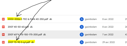

download the 2007 manual which pretty much covers the 2004. There is another file that covers FICHT and ETEC. Do some read-up
