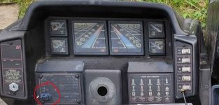

i have a 2 prong kill switch from a bayliner that i am trying to install into our 1985 omc stringer 400. any ideas on how to hook this up?

its a switch from a 1980s bayliner capri inboard 2 pole. going in to 1985 sunray. do i hook one from the neutral wire then to the yellow /red? or yellow/red then ground the other? i installed this dash and it came with the kill switch witch is 2 prong. will post pic

Ayuh,..... Yellow/ red is the Start circuit,.... Purple is the ignition,....

what part of you wire it in the purple wire did you not understand from post #3?
red is battery power
yellow/red is start
purple is igniti0n
you take the purple wire , you cut it, you put the switch between the two cut ends of the purple wire.

well for one thing, i dont have a ignition that has purple, 3 spades. is all i have on it. i have bat, start and acc. no purples at all. the engine is a omc stringer 400. second. i like the look of the bayliner guages and dash. they work just as well as any others out there. why knock someones ideas ?

my bad, i just checked again and yes i do have purple. so i will be hooking the kill up shortly. thank you all for the help.
