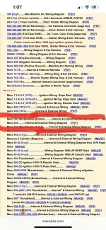

This was my assumption, but wanted to confirm with a proper wiring diagram. Any ideas where I can find an accurate one? I found a website with lots of wiring diagrams. Which of the ones from the attachment do you think would be correct?
Here's where my confusion comes in. I can start this with the pull start without having to switch anything to a run position. However, any wiring diagram I look at says the key needs to be in the run position when starting it with the electric starter via the remote control box. I'm wondering why it needs to be in a run position. I thought that maybe the run position allows it to charge when using the electric start with the remote control box.
I can currently start it with the electric start by bypassing the starter solenoid. I feel like I could rig it up to do this indefinitely, but I'd like to bring this as close as possible to it's original operating functionality.
Honorary Supreme Mariner
39,947
The motor does not need 12 volts to run.----Just needs 12 volts for the starter to crank it over.-----Most outboard have a stop switch / button to short the ignition to ground to stop them.
