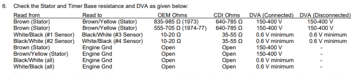

Interesting that on the CDI chart you linked to under my motor (85-140hp 1973-1977) it just says N/A under power coil as in there are no DVA measurements. The CDI troubleshooting guide calls for these various measurements under the same motor:
I feel like some of these have been cut and pasted from other motors. For example the coils on these motors have the orange wire permanently attached, not removable like the later style coil on the twin powerpack motors. Yet the guide says to "Disconnect the Orange wire from the ignition coil".
Dont know where you got the spec but here is the correct ones..

Are you looking up a different motor to mine? I get this straight from the 7th edition CDI troubleshooting guide from the CDI website.
gilera
Aug 29, 2021
60
Is it just me or does the spec sheet that Faztbullet posted have an error? The table shows that Black/White to gnd should be 0.6V, but then point 9 says it should be at least 150V.
Sounds like you’re confused as to what is going on.
You’re dealing with a capacitor discharge system. Voltage is built up in a capacitor then collapsed (discharged) and the process starts over again.
As such, you’re dealing with pulsed AC similar to the trace shown below.
Note the duration of each peak collapse cycle. It’s these peaks, and only these peaks you’re trying to capture with a DVA.
Your 150V is the peak AC output on the “supply” side.
The 0.6V is mostly rectified DC (with a bit of AC in the trace) after filtering
