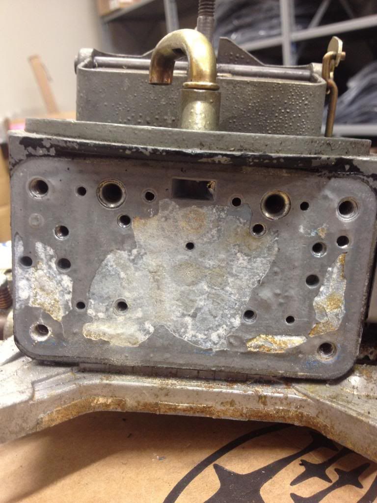

Carburetor body corroded, unable to rebuild. Carburetor was also a reman automotive carb semi converted to marine spec.
Replaced carburetor ok now.
