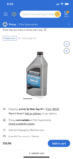

Ok but they do carry different thicknesses.

That’s the Premium Gear Lube. Different product. You want the High Performance Gear Lube.
I’ve used it in my OMC Cobra for 15+ years at the advice of my now retired mechanic. It runs quiet and shifts like new.
As Lou Said that is Premium Gear Lube which is clear brownish yellow in color. The High Perf gear lube is bluish green, can't confuse the two.
While it used to be spec'd for the older alpha one gen one (1990 and older) Premium lube is now labeled for outboards and jet pumps 75 hp and lower. I suspect this is to prevent people from using it in the newer Alpha One Gen 2 drives.
High perf is for alpha and bravo drives
This is the one you want https://www.walmart.com/ip/Quick-Si...VA6bICh2boQlXEAQYASABEgKo3_D_BwE&gclsrc=aw.ds
