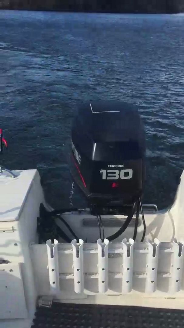

And lastly, here is the engine at idle, in gear after a long run. Doesn't seem like a carb issue to me because I doubt it would run like this at all if it were.I have been through these carbs 3 times and unless the plastic is warped I just dont see how I could still be having carb issues.

the video of the motor at idle....I don't see how you could expect it to be better than that...that's smooth for a 2 stroke
